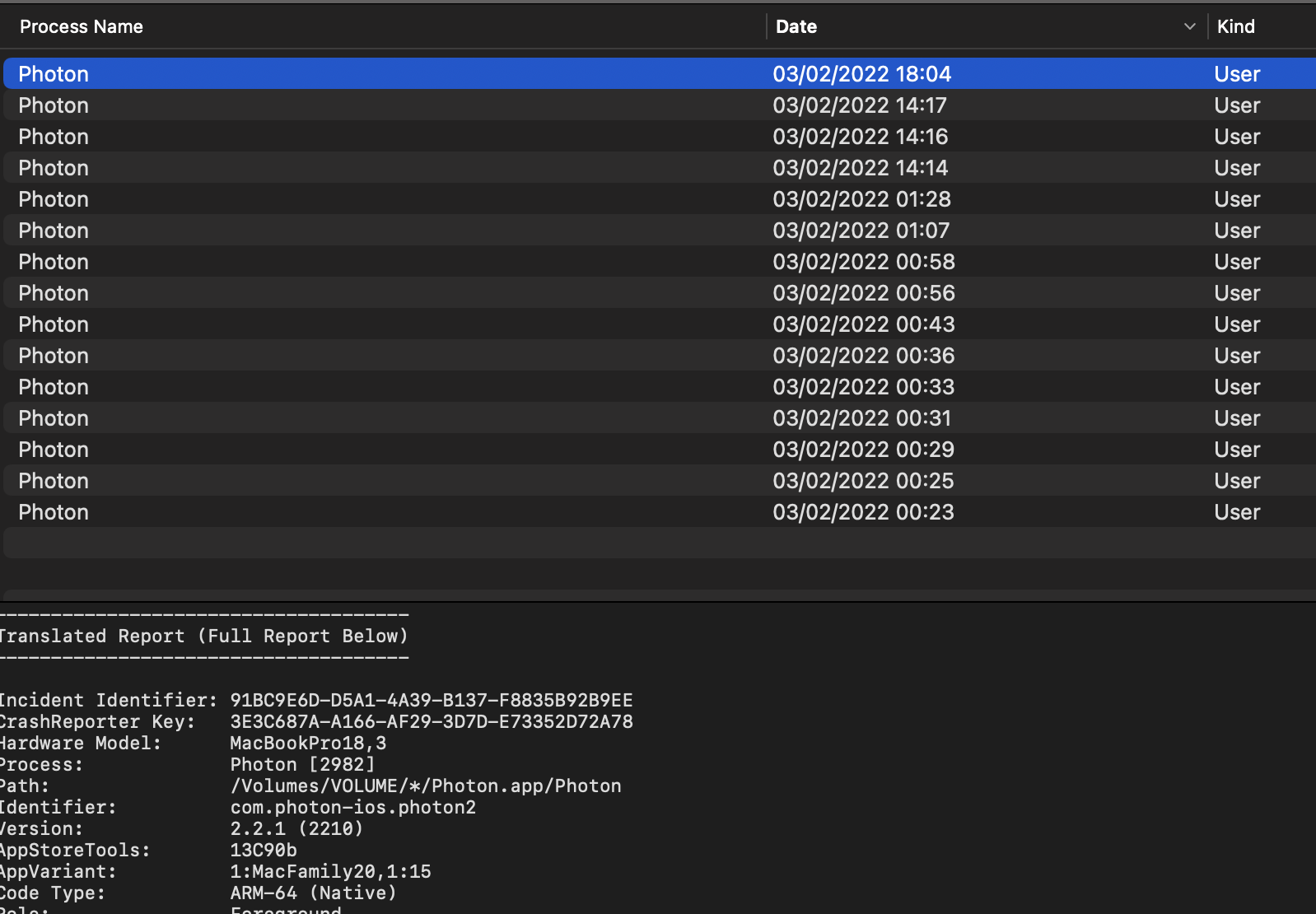

Hi, I’m currently trying out photon (2.2.1) for the first time and I already have dozens of crashes (certainly from the same type of crash).

It happens when I’m navigating in and out a group controller. By the 10th I do this action, the app crashes.
Could you help me with thoses?

Hello
Have you sent report on the restart of app?
Yes, multiple times, otherwise I can send you the full crash log
Yes i see it
It’s seems a macOs related issue
I have 13 reports of this specifically on MacBook Pro M1 and new M1 Pro/Max
Like I said I already have a dozen of thoses (which could have been sent).
I must be the only one to have this bug for sure…
found another one ^^"
