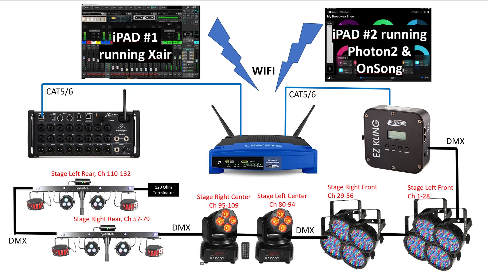

This is my setup. Works very well and I have Photon2 running in the background behind OnSong, which sends MIDI messages to Photon2 to trigger different light shows at different parts of my various songs:
