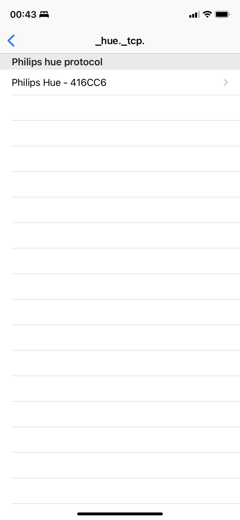

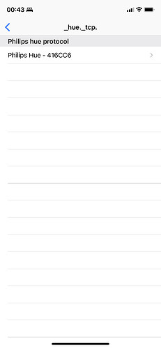

I use free Discovery app when I have connections problems to try to check if zeroconf devices are announced properly

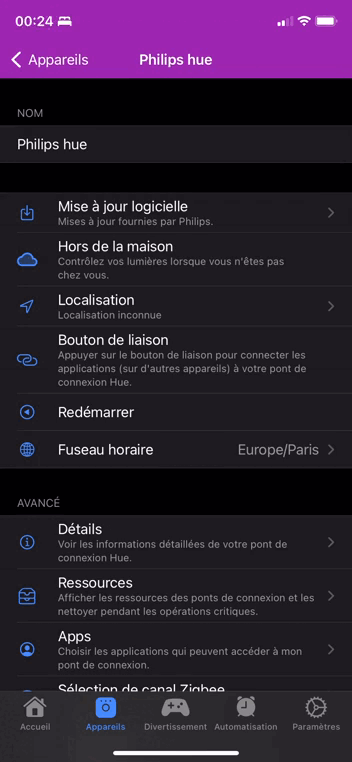

And with the free app Hue Essentials, i have removed a lot of unused tokens and my bridge has accepted my app again

On my side when I had problems with Hue connection, I see with this app Hue Essentials, a lot of unused token and too much ressources created by google home, etc…
if Hue bridge is too much feed, the bridge can be unstable.
