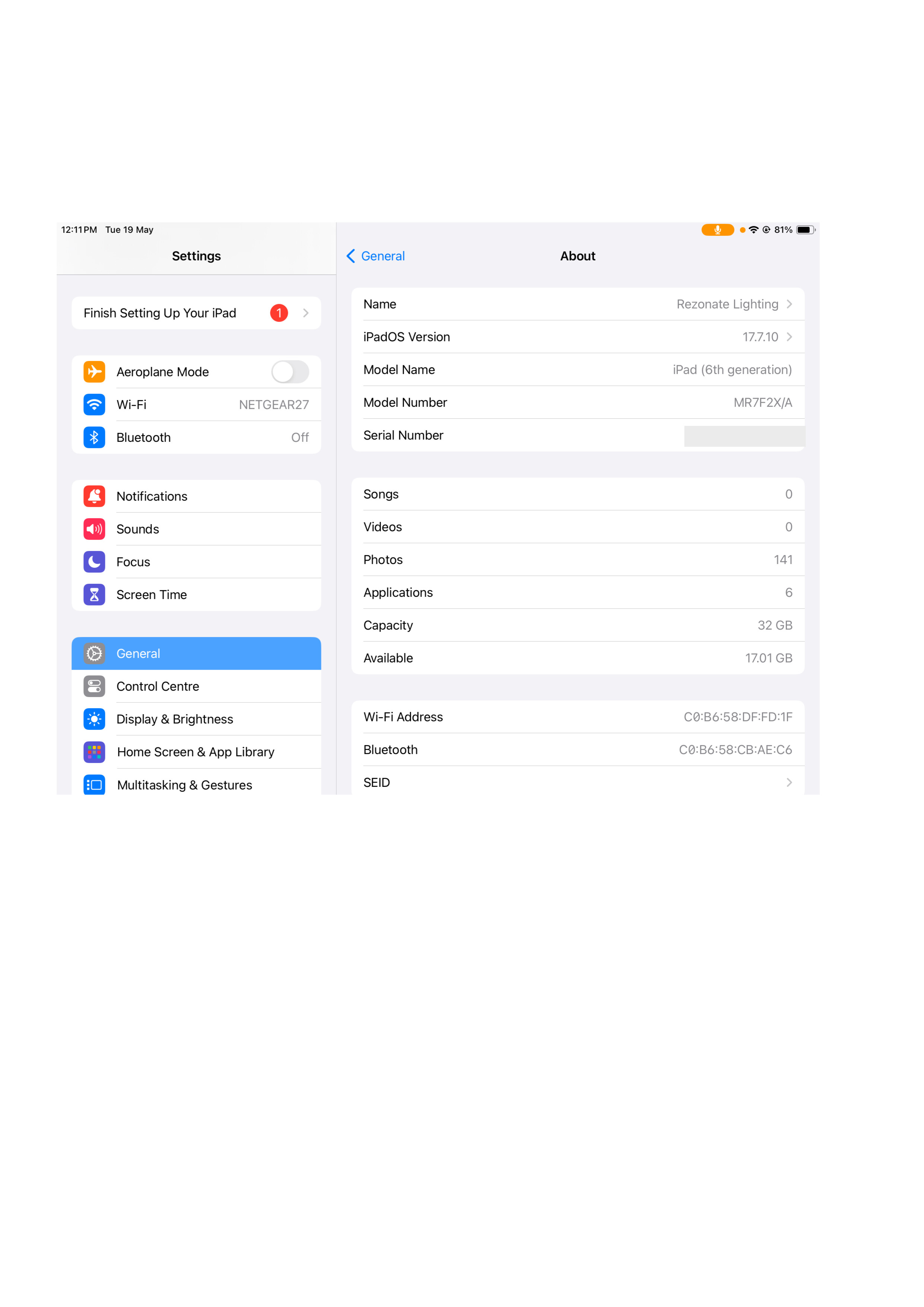

Hi, thanks for your response. I’ve made a video demonstrating the issue, and a pic showing the specs for my main lighting iPad. But it’s the same on every iPad I’ve tried it on, including an iPad Pro 6th gen. I make a preset just for one fixture. But when I select that preset it also affects other fixtures not in that group, and not in that preset. I’m assuming that shouldn’t happen. It works fine on the ‘Live’ page. But it would be great to be able to select multiple presets on the ‘Light Control’ page, especially when making more complex presets.
