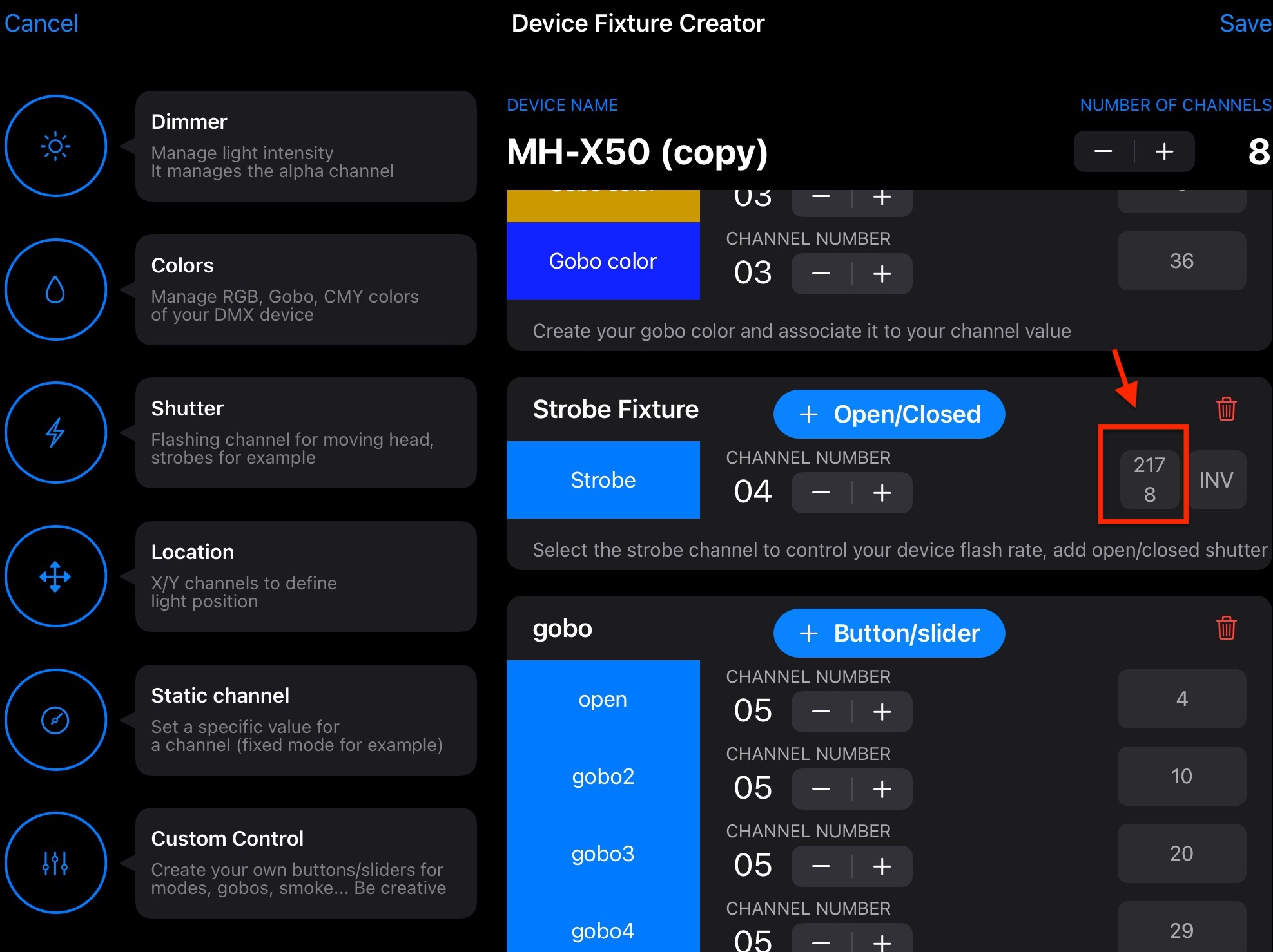

Hi, I am currently testing the app with a stairville mh x50 movinghead and the preinstalled 14ch template.
I have given the movinghead the dmx address 1.
So all channels should be testable with the free version or?
But unfortunately I always have strobe activated even if I set the fader all the way to 0. At 100% the strobe is very fast. Is it possible to adjust something manually?
Thanks for your help!
Greetings
Good evening everyone, I looked at your topics and now found the problem in the preset. i love the function to be able to copy the preset. so I could adjust the strobe manually. Thanks for the app. :+1: :heartbeat:
We make preset with pdfs but some time we can do some errors
Thanks for fix it
