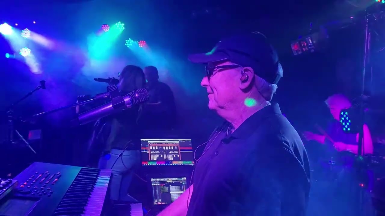

This was a first tryout of Photon 2 using MIDI cc and note messages.

Thatâs really impressive! Are you using particular keyboard note/notes to trigger photon presets on/off or is Multitracker providing all the MIDI messages to Photon and you are playing keyboard along with that? I currently trigger sequences based on song selections but would also love to trigger some presets from my keyboard playing directly.
Thanks! What i did was created a bunch of presets, 3 sequences and a few faders. The control surface only used 1 square each regardless of it being a button or fader (so i could have a bunch of options). Then I set each preset and sequence to a MIDI note (flash, type) and faders to CC#. Then imported each backing track (mixed down to a single file) into Cubasis and set each note/fader to the music. Used MIXDOWN to export only the MIDI track. Then I dropped that MIDI track into the song on Multitracker. So, all lights were fully automated.

Here are a couple videos indicating MT running our timed DMX light show on a MIDI track in MT. The lights do not flash faster than 1/8 notes, and I try not to do the same light flashing sequence more than once or twice.
The lights pointed at the band are DMX timed with MT, and the lights pointed from behind the band toward the audience are sound triggered.

That looks so amazing!! Really well done, it adds so much action and wow to the show. I hope we can make it work as well.

At night, with the smoke and the space used it looks great! Honestly, the music drop synchronized with the flash is very very cool, bravo I love it!
Are we allowed to use some of your videos for Instagram or even later for Photon ads?
Congrats and as usual thank you for sharing itâs a pleasure.
Hi Clement,
Feel free to use them. The ending of Donât Stop Believing and the hits on Play that funky music are the most noticeable. Our drummer wanted me to program more accent flashes, but that will have to be for next year since our last gig for 2022 is 10/29. We plan to use November and December to handle some health problems and pass my clinical exam for licensure. Busy, busy! I am honored that you are using and sharing the videos!
