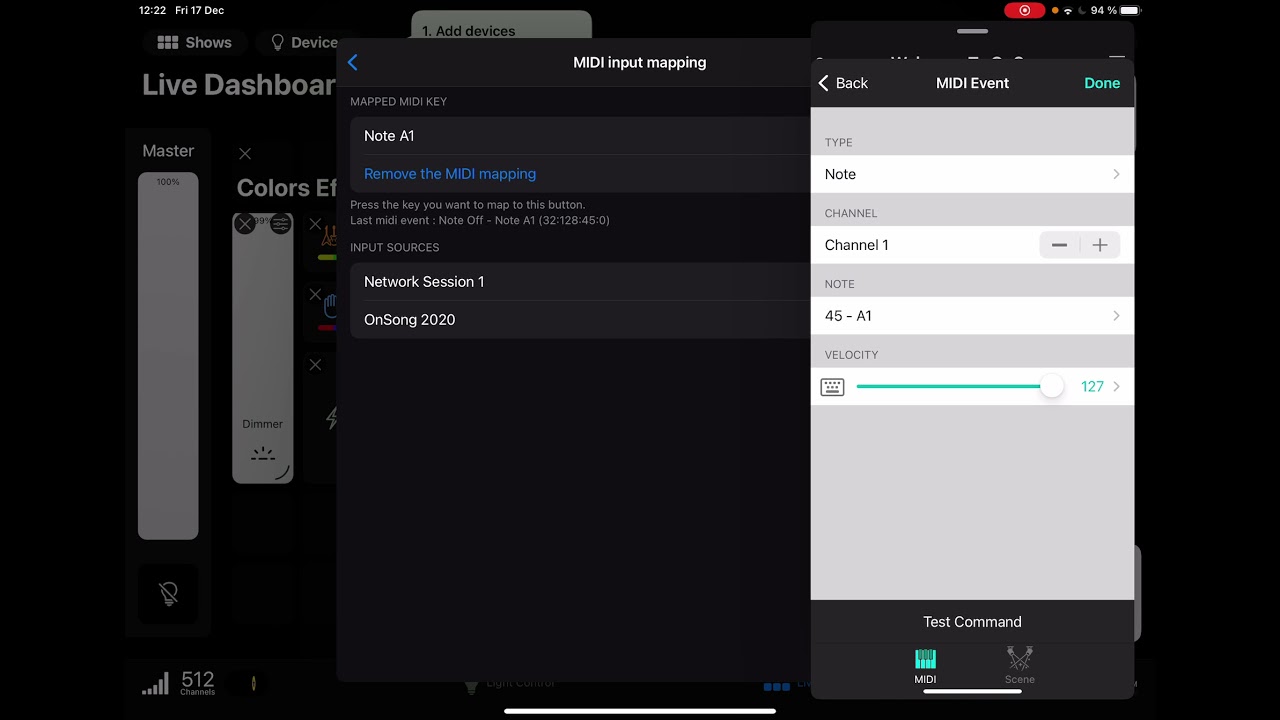

It works! Any idea why my MIDI message sent (Control 14, Channel 1, Value 53) is interpreted by Photon as “Note D-1”?

Yes it is normal for the note. You can refer to this table for the control 14
Great. Now I have “Note D-1” associated with my Live Button “Preset Beat Snap”. I put Photon into Live Mode. When I send the MIDI message from Onsong shouldn’t the button in Photon activate showing that “Preset Beat Snap” was toggled on by the receipt of the MIDI message? It currently does nothing.

I tried a different Midi message and now the button responds by toggling on or off when the message is sent. Works both in Live and not Live mode. Not sure that Photon acts on the change in the background until brought to the foreground. (See screenshot and video link below)

I think it’s now working with Photon in Live mode in the background. See video of 3 different songs, issuing 3 different midi mesages, triggering 3 different presets/sequences.
